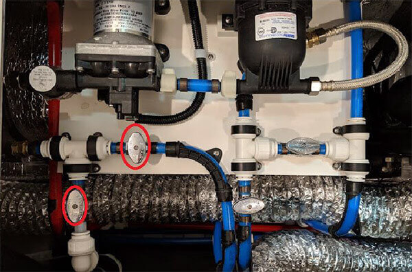

4. Turn water pump valves back to standard configuration. The water pump valves are located inside the same access panel that we just used for the fresh tank drain. There will be 4 silver valves (2017 and newer models) or 2 brass valves (2016 and prior models).
2017 and newer models we will turn the two valves located on the left of the water pump.
The picture below shows the valves in standard configuration and the valves outlined with red are the only ones you should need to turn in order to change the system from winterization mode to standard mode.
Water pump valves back to standard configuration
Change the winterization mode to standard.

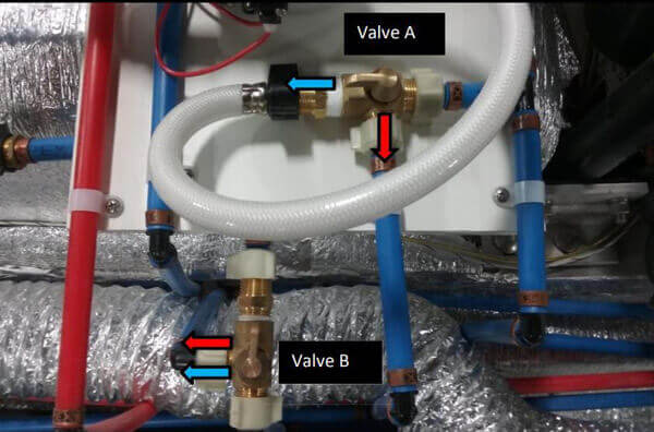

The picture below shows the valve configurations for 2016 and prior models. The valves are shown in standard mode. The blue arrow represents the direction the valve is turned for winterization.

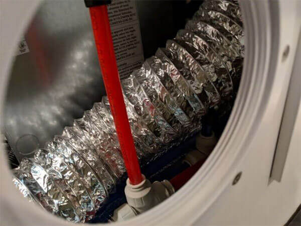

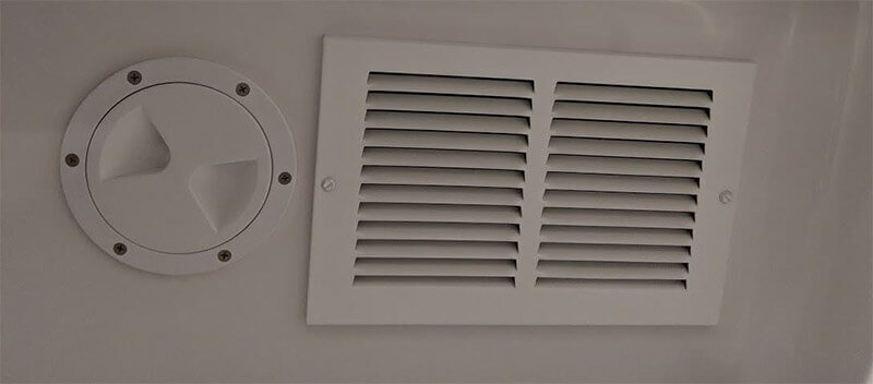

The water heater bypass valve is accessed inside the trailer via the 4” deck port under the curbside bed. The deck port is located next to the furnace air return vent. See picture below
water heater bypass valve location
Water heater bypass valve location

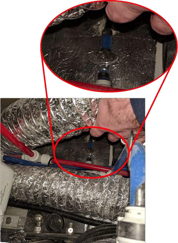

Below picture shows furnace duct running on top of bypass valve. You will need to lift the furnace duct up out of the way to see the bypass valve.
Bypass Valve
Bypass Valve

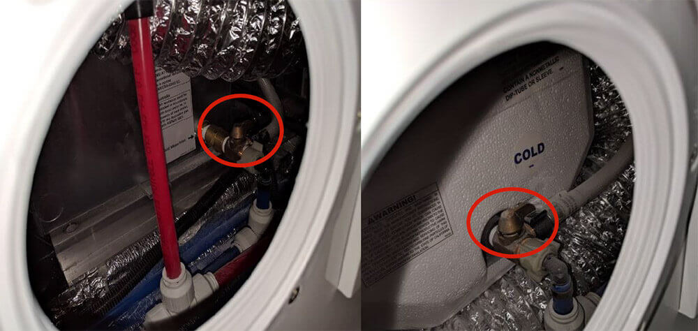

Below pictures show a Truma and Suburban Water Heater bypass valve currently set in winterization mode. You will need to turn the valve towards you to open the flow for cold water to enter the water heater chamber.
Truma and Suburban Water Heater Bypass Valve
