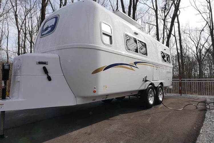

In this article we will be discussing some of the different components and how they operate inside your camper as well as safe and potentially dangerous power connections. Your Oliver Travel Trailer is designed with a 30-amp shore power connection on the street side of the unit and some campers may also have an optional convenience 30-amp power connection on the front LP housing. Both of these connections can be used with campground pole connections as well as a generator.
Your camper has a built-in transfer switch to determine where the power is coming from and will automatically switch between the two power inlets to supply the power to your main power panel through the surge protector.
