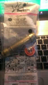

Neither one of us had ever used a shark bite coupling before, and, it was a bit strange looking, so, we read the instructions on the package. Truthfully the instructions were so straightforward and simple we were not sure that they would work! Here are the photos that we took of his repair as we went along.

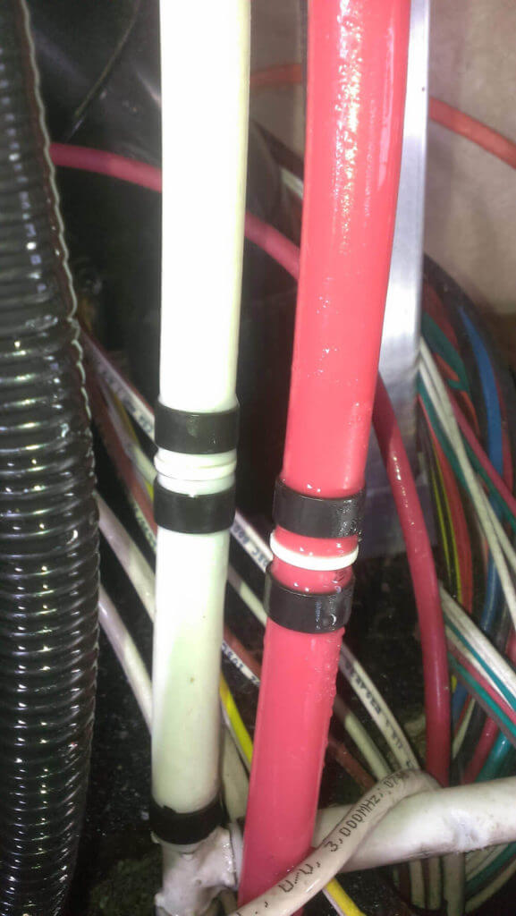

In this photo you can see the hot and cold water pipes that have a conventional PEX coupling with the compression rings on each side.

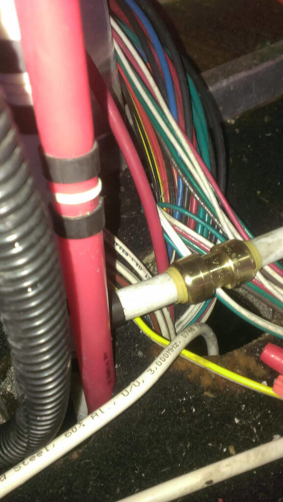

In this photo the brass colored SHARKBITE connector is already in place. The hardest part was getting a square cut on each side and carefully removing all burrs left by the hacksaw with a pocket knife. After that it was simple to firmly push both ends into the connector.
Betty discovered that I had bought two different sizes, I had forgotten that also. In the photo above is the longer one and the short one was used for the repair. Click on the photos for a larger view.
