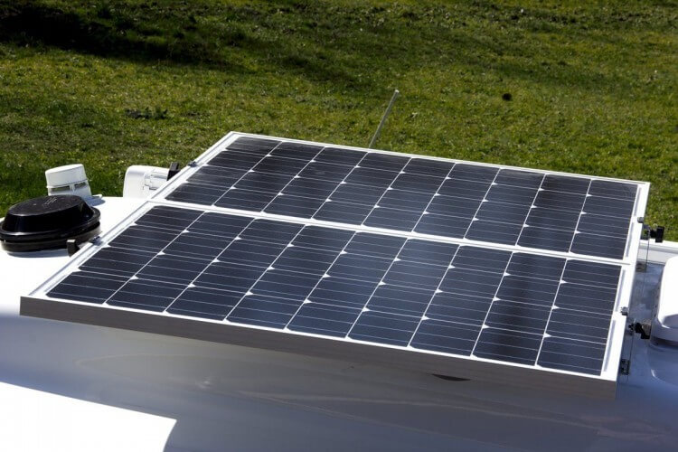

The Oliver folks have made some wise decisions about the equipment provided in the optional solar battery charging system. Everything you need is there and it is all top quality stuff. Up on the roof are two 36 cell mono-crystalline panels with a total of 320 watts. The electricity they generate is linked together in a roof mounted combiner box and then sent inside along two 6 gauge wires through a 30 amp cut off switch and on to the Blue Sky Solar Boost 2512iX-HV MPPT Charge Controller. From there it is passed thru a 30 amp circuit breaker and a 50mv/500amp Shunt which is monitored by the Blue Sky IPN PRO Remote Meter inside your coach. All this is assisted by a Temperature Compensation Sensor at the batteries. Now you have to make a choice… “which battery should I choose?”
