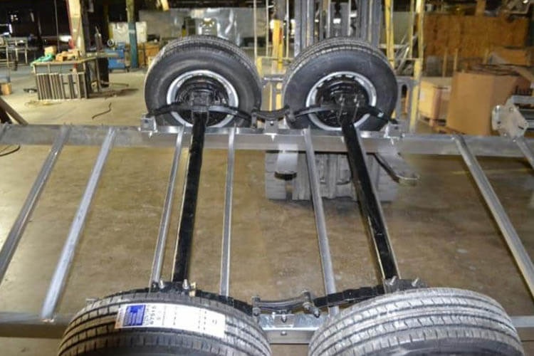

travel trailer frame
The fresh water and the grey water tanks are longer and flatter, and the tongue jack can readily effect the filling and emptying efficiency of them.
Here is a look at an Elite II frame so you can get an idea of where those tanks are located and their long flat configuration. In this photo the frame is upside down while the axles are being attached. None the less one can readily see where the tanks will be located when turned back over, making the center of gravity very low for better handling.
