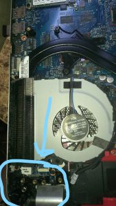

We are pretty careful with the laptop and put it in a padded place when not in use. But, when putting on lots of miles, sooner or later it will take a hit. A screen hinge broke on ours, during the latest episode. It continued to work, so I just opened it up carefully, until the day that I heard something go into the cooling fan. It wasn’t long before this message came up upon boot up.
laptop travel trailers

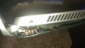

It was time to do something alright ! I should have known that I was headed for trouble when the broken hinge caused the case to start to separate, here is a look.
inside of laptop repair

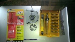

Knowing that the fan was likely damaged, I had one mailed to our location. A quick check of youtube let me view a fan replacement and hinge repair video. It seems as though a broken hinge is pretty common and there were some good tips and hints there. Placing a small fan near the case separation kept the laptop from shutting down due to overheating and I gathered up these items before opening up the cases.

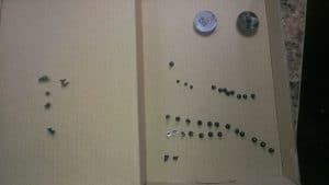

I was not prepared for so many tiny screws of different sizes, but other than that, the disassembly was pretty much straight forward. On the left are the plastic pieces that jammed the fan.
laptop screws
